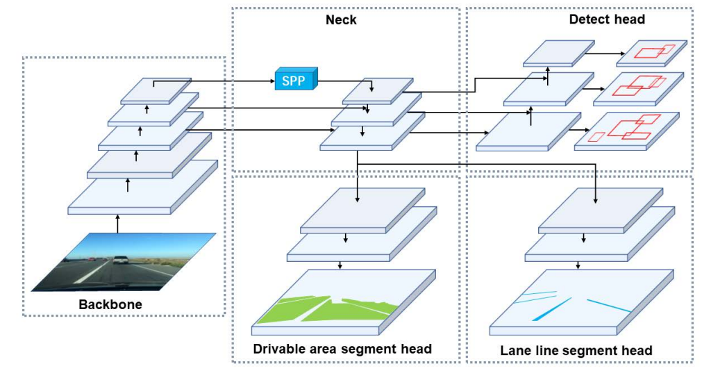

The network structure of YOLOP is very clear, which is basically consistent with the network of YOLO series. Mainly referring to the model structure of YOLOV4, YOLOP’s network is mainly divided into the following parts:
- backbone
- neck
- Detect head
- Drivable areas segment head
- Lane line segment head

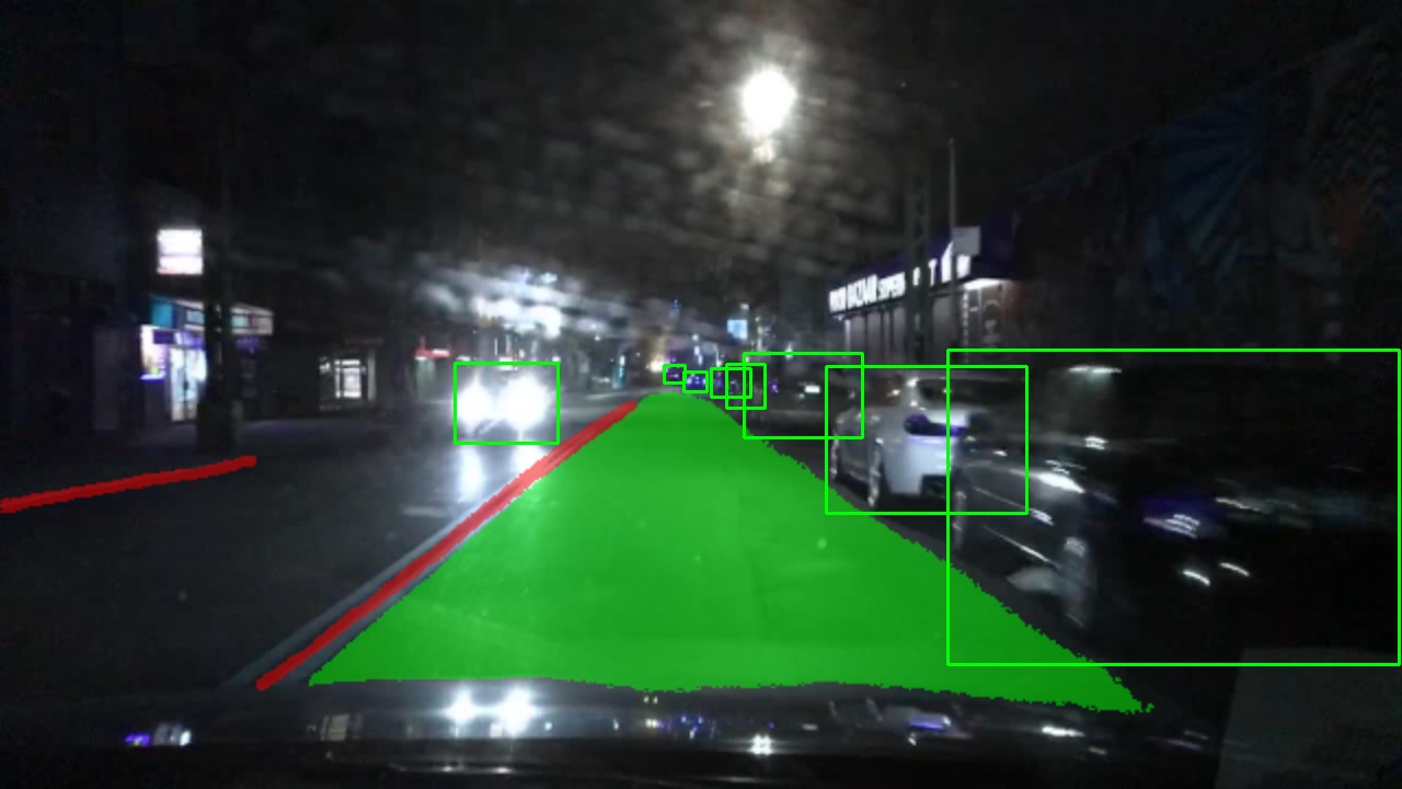

output.jpg As you can see from the above figure, all three visual tasks have good results, especially at night, YOLOP is a very powerful model.
