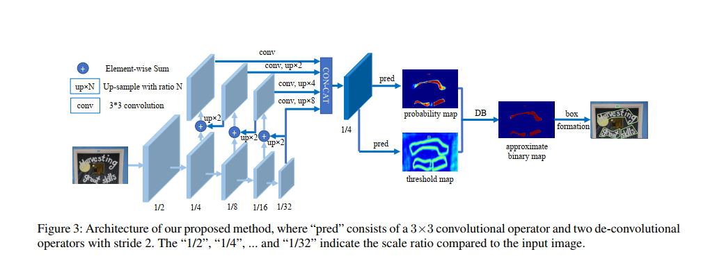

2.1 Introduction to the model
dbnet is a widely used model for text detection. Its essence is a segmentation model, which will eventually segment the text area on the image. Its model structure is as follows:

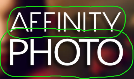

2.4、 results
The closed curve in green is the text box area recognized by dbnet.

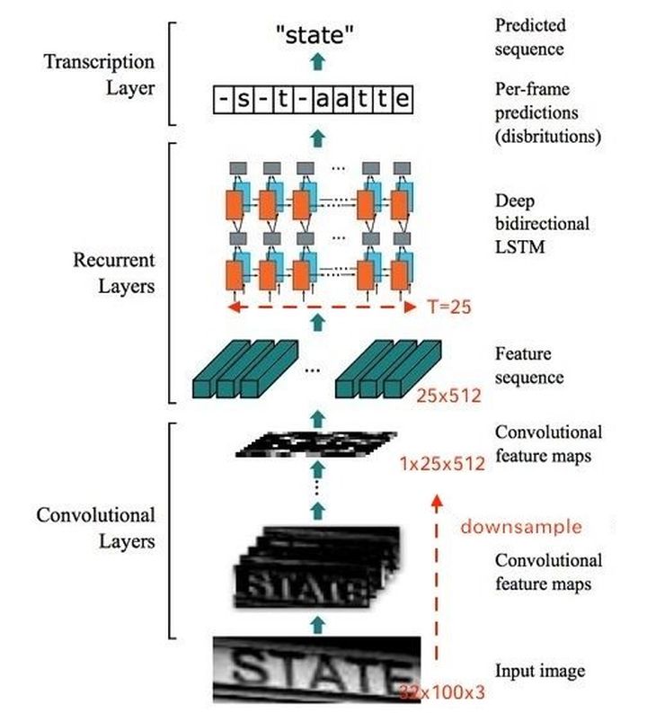

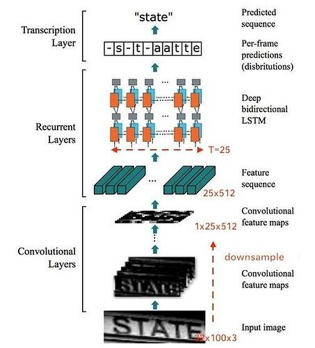

3.1 Introduction to the model
crnn is a convolutional recurrent neural network, which realizes the combination of CNN and LSTM to extract image features, and finally uses ctc decoding to realize text recognition. The model structure is as follows:

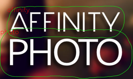

4.3 results
predict.png From the result, dbnet can accurately predict the text area, of course, it can also adjust the size of the text area by adjusting the threshold of dbnet, and crnn can well identify the English letters in the text area.
