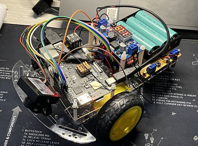

Car chassis
There are many kinds of car chassis: four-wheel drive type, two-wheel drive + one free wheel type, McNamm wheel type, omnidirectional free wheel, two-wheel balance type, etc., its difficulty, effect, error are also different.
After comprehensive consideration, we have chosen a two-wheel drive + a free-wheel type car with simple use and great steering flexibility! [two wheel drive + a free wheel car] (/ API/v1 / static/imgData / 1682168624406. PNG)

Power supply: 18650 battery (3C or 5C!!) +LM2596S stabilized power module The 18650 battery is also a commonly used power supply for making cars, but with the battery consumption, the voltage will change, so the voltage regulator power module is needed to stabilize the voltage, considering the capacity and current, the owner uses three 5C 18650 batteries. ! [18650 c] cell 5 (/ API/v1 / static/imgData / 1682170970727. The PNG)! ] [LM2596S regulated power supply module (/ API/v1 / static/imgData / 1682170986024. The PNG)
It should be noted that the X3pi needs 2A current to turn on normally, the 18650 battery of 3C or 5C to ensure its current supply, the power module also needs to pay attention to the maximum current that it can output (3A or more insurance), it is best to adjust the output, with the number of display 3 board, the students who are not confident in the wiring can also find a reverse connection protection.
Connect the positive and negative cables of the X3pi to the positive and negative cables of the Type-C cable to supply power to the X3pi.

Two, hardware connection The basic connection route is as follows! [circuit connection diagram] (/ API/v1 / static/imgData / 1682183827415. PNG) Regarding the pin connection of the X3pi, note: ! Synopsis] [sunrise X3pi 40 pin pin (/ API/v1 / static/imgData / 1682922435815. PNG) Set the pin mode to “BOARD”, but the function of each pin still persists, for example, pin 9,14,25,30,34,39 is a ground signal pin and cannot output a high level. In order to prevent interference from other pin functions, it is best to use GPIO model pins, such as: 11,13,15, etc.; Second, it should be noted that only pin 32,33 has PWM capability.
