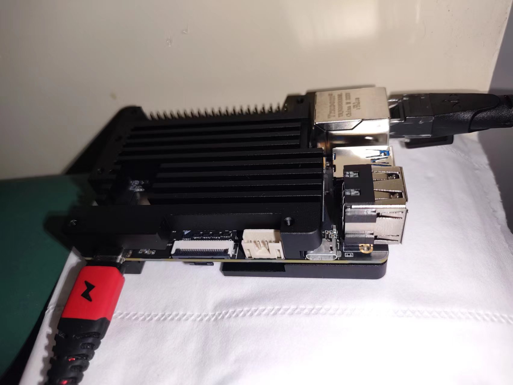

typec support is also very friendly! Can be powered directly with 65wpd charger
The question follows: After brushing the system the day before, the link screen test is normal. Connected to the Internet and threw it in the weak box, and the cable is good. If you want to use the host name directly for x3 dispatch access, the host name ubuntu cannot be pinged directly. But there’s no router admin password. In line with the lazy can be lazy mentality, so try to solve directly remote.

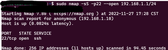

Use nmap for port scanning
Installing nmap
sudo apt install nmap -y
You can run the following command to scan for a specific network segment, for example, my LAN is 192.168.1.1/24 The scan result is the host with SSH Server enabled
sudo nmap -sS -p22 --open [网络]
# for example
sudo nmap -sS -p22 --open 192.168.1.*
sudo nmap -sS -p22 --open 192.168.1.1/24
nmap scan

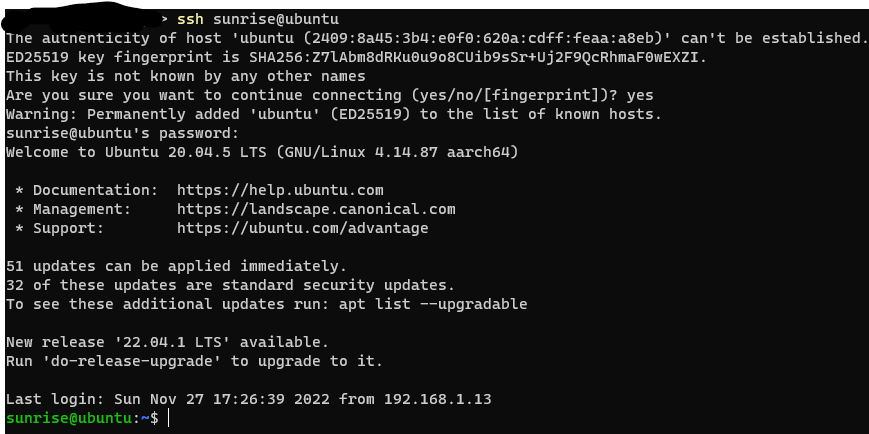

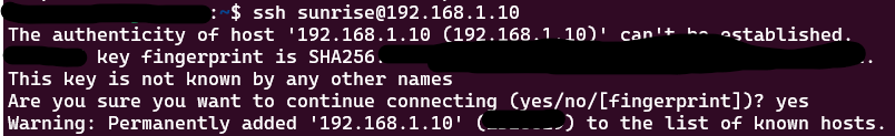

ssh sunrise@192.168.1.10
Connection successful ! SSH

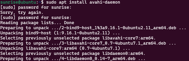

Use a small service ‘avahi’ you can broadcast the host name in the LAN, then you can directly use the host name to access ‘X3 pie’, no longer have to worry about ‘dhcp’ caused by ‘ip’ changes have to find the host again. Install ‘avahi’ using the following command
sudo apt install avahi-daemon
avahi
reboot

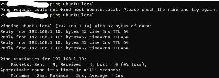

Before and after the system takes effect, the system can be accessed using the host name
ping ubuntu.local
ssh can then write the host name directly, and it can also be written in the ssh client
