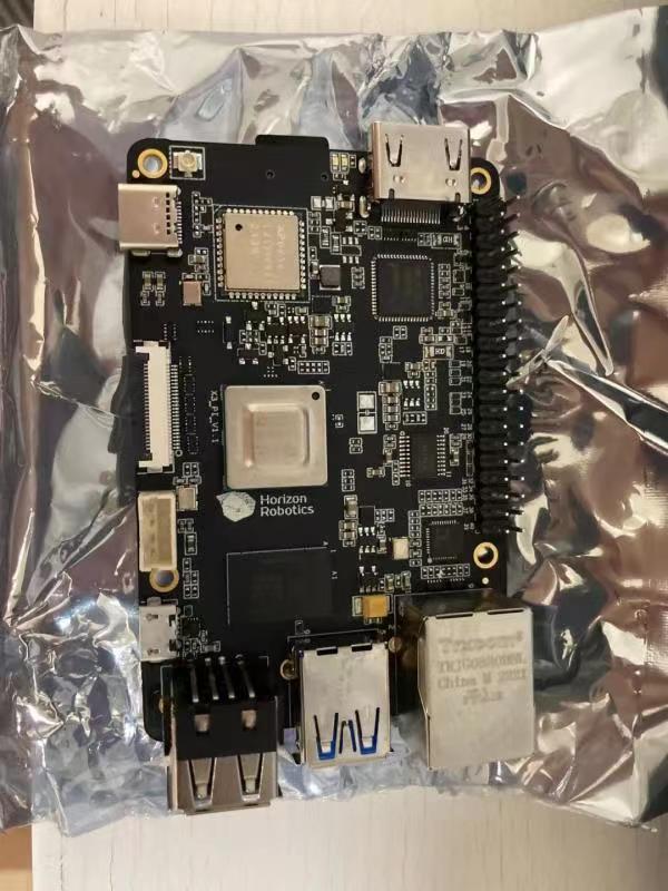

The hardware mainly uses the Sunrise x3 development board, Lakibeam 1 LiDAR, and JY61 gyroscope module, followed by the power module, 12V lithium battery, PCB board, acrylic structure, and handle structure.
The Xuri X3 development board is a development board based on ARM architecture, using the Cortex-A53 architecture of the Allwinner H3 processor, with a main frequency of up to 1.2GHz. This development board has multiple interfaces and extension interfaces, which can meet the needs of different application scenarios. At the same time, it supports Android and Linux operating systems and can be used in fields such as smart homes, smart Internet of Things, and embedded development. This development board is equipped with 1GB of DDR3 memory and 8GB of eMMC storage, and also supports TF card expansion storage. In addition, the development board also supports WiFi and Bluetooth functions, making it convenient for developers to communicate wirelessly.

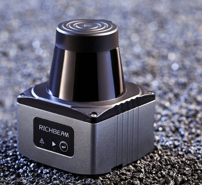

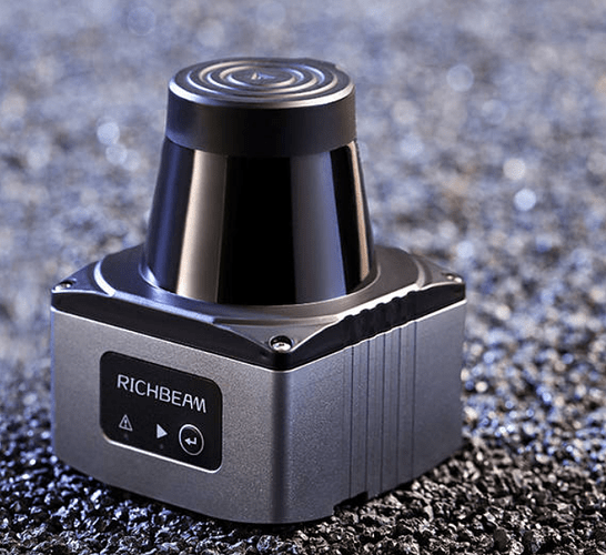

Lakibeam 1 LiDAR is a high-precision LiDAR that uses solid-state lasers and high-speed scanning technology to obtain real-time 3D point cloud data of the surrounding environment, and has the characteristics of high precision, high resolution, and high reliability. The Lakibeam 1 LiDAR also has the advantages of being compact, lightweight, low-power, and easy to integrate, which can meet the application needs in various complex environments.

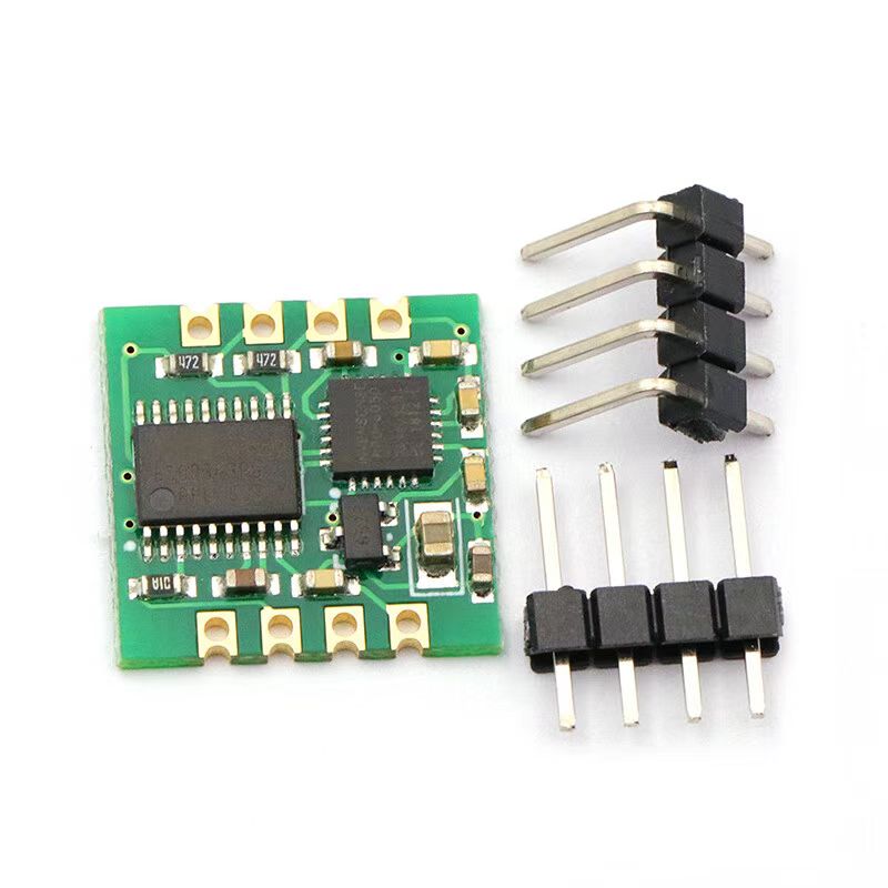

The JY61 gyroscope module is a sensor module that integrates accelerometers, gyroscopes, and magnetometers, capable of measuring data such as acceleration, angular velocity, and direction of objects. This module adopts MEMS technology, which has the characteristics of high precision, high stability, low power consumption, and small size, and has a wide range of applications. It adopts I2C or serial communication mode, which can be connected and communicated with microprocessors or microcontrollers, making it convenient for users to process and control data. At the same time, the module also supports multiple data output formats, including raw data, angle, angular velocity, acceleration, etc. Users can choose the appropriate output format according to their own needs. In applications, the JY61 gyroscope module can be used for attitude control, navigation, motion control, and other aspects. For example, in robots, the JY61 gyroscope module can be used to measure the tilt angle and motion status of the robot, thereby achieving automatic navigation and control of the robot; In autonomous vehicles, the JY61 gyroscope module can be used to measure the acceleration and angular velocity of the vehicle, thereby achieving stable control and autonomous driving of the vehicle.

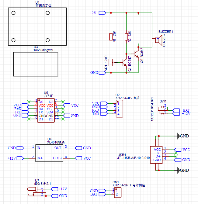

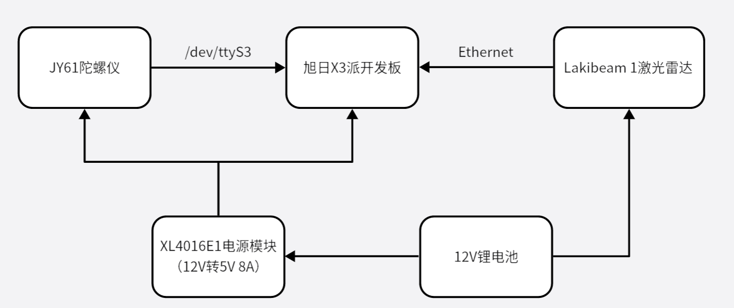

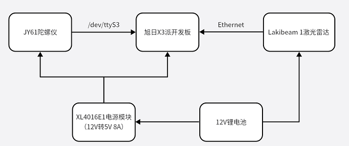

The following is the hardware framework diagram for this project.

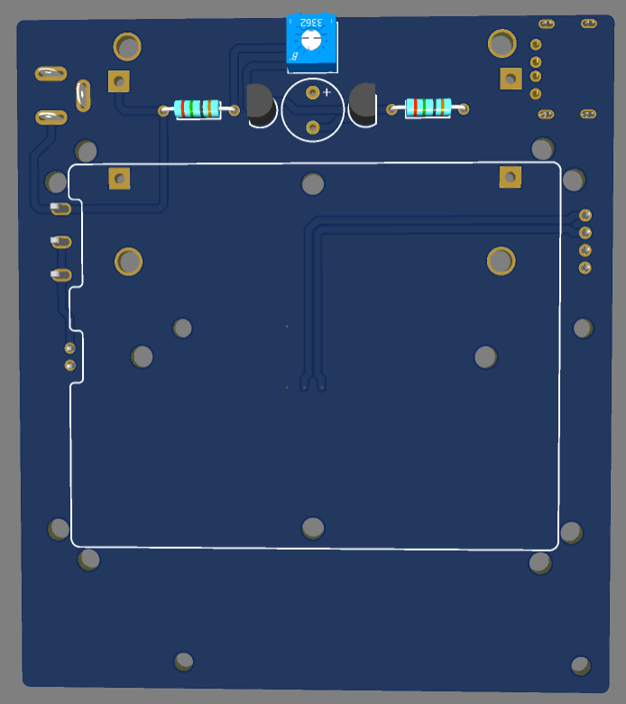

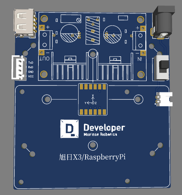

The entire system is powered by a 12V lithium battery. Realize 12V to 5V 8A (Max) power supply for the Xuri X3 development board through the XL4016E1 power module. The LiDAR uses Zhichi’s Lakibeam 1 single line LiDAR and is connected to the Xuri X3 development board via Ethernet. The gyroscope uses Vite Intelligence’s JY61 module (which has been discontinued and can be replaced by JY60/JY61P/JY901, etc.), and is connected to the system through the serial port function of the Xuri X3 Pai IO pin (the serial port number is/dev/ttyS3).

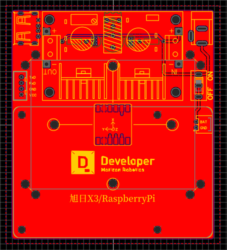

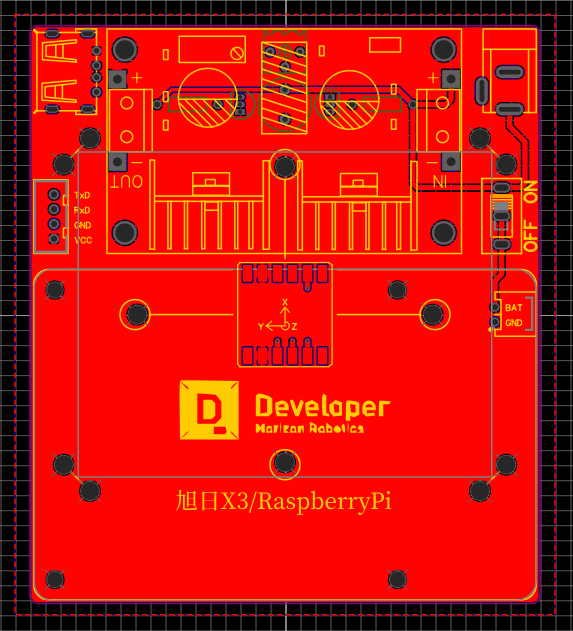

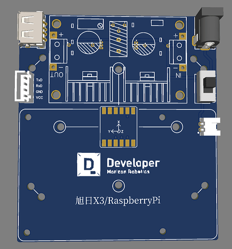

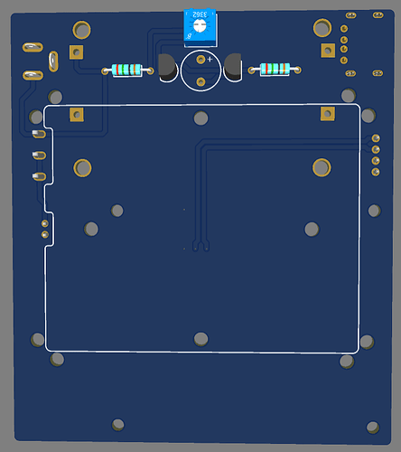

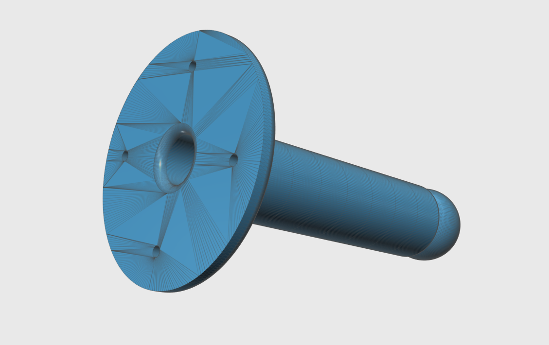

I have briefly designed the PCB and structural parts here, as shown in the following figure.
Handle section (3D printing)

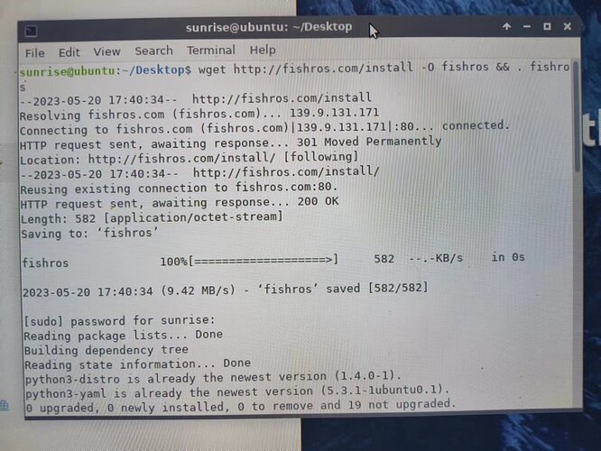

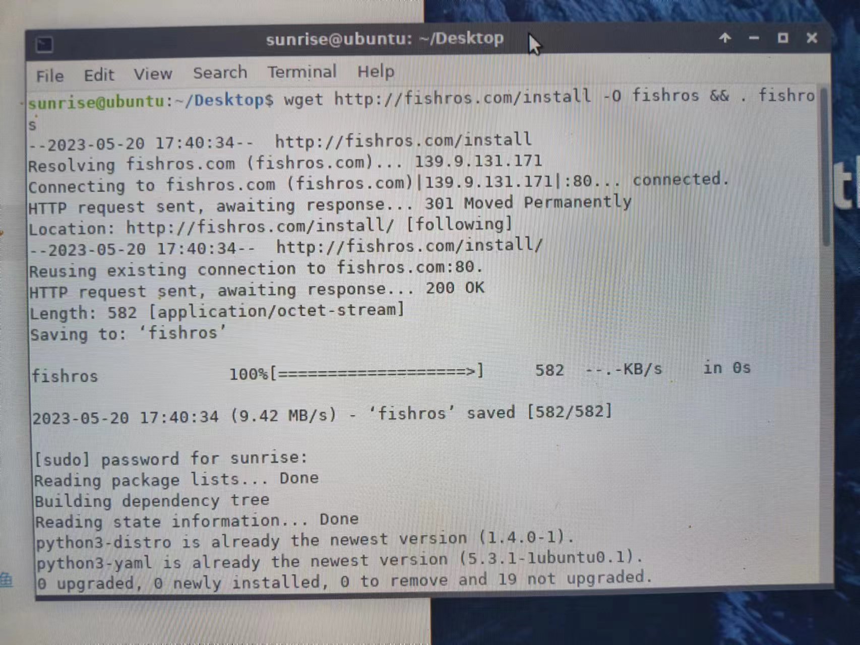

I am using the Ubuntu 20.04 Desktop version of Xuri X3 Pi here. Next, let’s configure the ROS environment. (ROS environment configuration steps, including source swapping, installation of ROS, execution of ROSDep, creation of workspace, configuration of environment variables, and direct replication of CSDN, etc.)
Before burning the Ubuntu system image, users need to make the following preparations:
·Prepare a Micro SD card with at least 8GB capacity ·SD card reader ·Download the Ubuntu image compression package and extract the Ubuntu system image file: systemi_sdcard.img ·Download the image burning tool balenaEtcher, download link: https://www.balena.io/etcher/ ·Obtain the Ubuntu image file of the development board from the resource center, burn it to the prepared SD card, extract the image file and download balenaEtcher, and open the image file with balenaEtcher
The next step is to create a workspace and feature package. The code used in this project has been uploaded to Gitee, and the download link is: https://gitee.com/zhao-yuanqi/sunrise\_slam.git

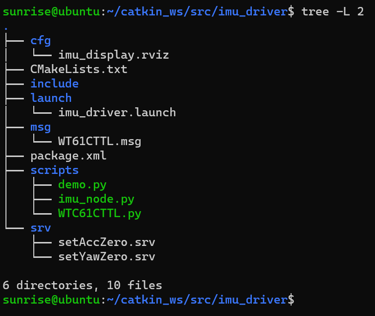

The detailed composition of the feature pack is as follows:
Cfg: Configuration file
Store the startup configuration file imu_display.rviz for RVIZ, and use the content I have configured directly when starting RVIZ for testing.
Include: No content, no need to consider.
Launch: Start file
Imu_driver.launch starts two nodes, among which the WT61CTTL node is responsible for obtaining data from IMU sensors and providing calibration services;

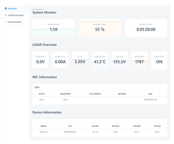

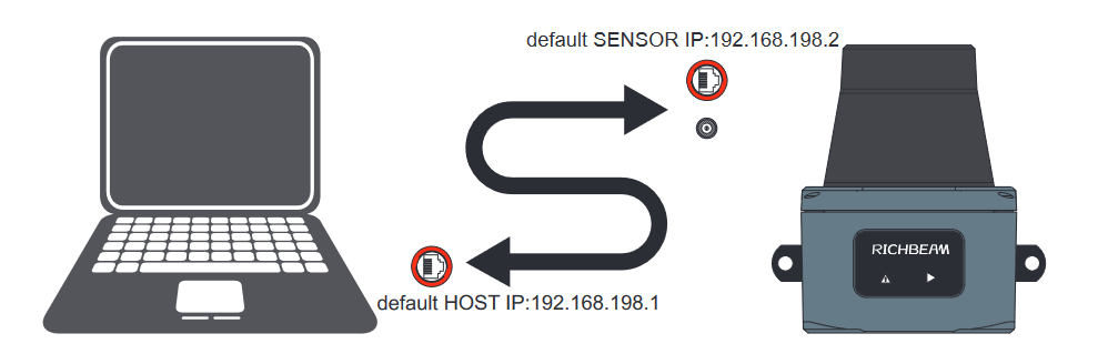

LakiBeam establishes a connection with the computer through a network cable and power supply. The default network configuration of the product is static mode, and the IP address of the device end is set to 192.168.198.2 (Device end) at the factory. The IP address of the Ethernet port connecting the radar and the computer needs to be manually changed to 192.168.198.1 (Host end) first, and then accessed through the computer’s web browser http://192.168.198.2 You can access the built-in web services on the device.

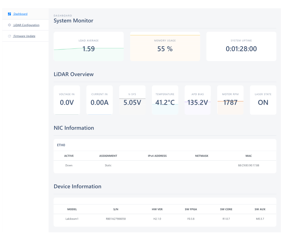

The dashboard page provides system status monitoring (including CPU usage, system load, memory usage, Ethernet data rate, and system running time), radar status monitoring (including input voltage, input current, system voltage, core temperature, APD bias voltage, motor speed, and laser ranging status), network card information, and device information.

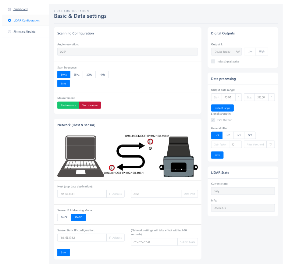

The LiDAR Configuration page provides radar scanning related configurations (including scanning frequency settings, start and stop of ranging); Data processing configuration (including data output range settings and data filtering settings); Data transmission target configuration (including the IP address and data port of the target host); Network configuration (including mode switching between DHCP and static IP, and setting of static IP). It should be noted that after changing the network configuration, the device must be restarted, and the new network configuration information will be automatically applied on the next startup.

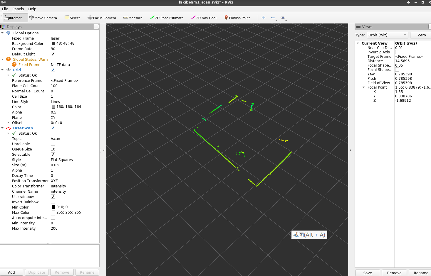

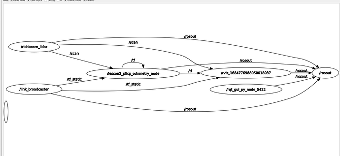

After configuring the radar IP and local IP, you can start the Lakibaem 1 LiDAR with the following command.

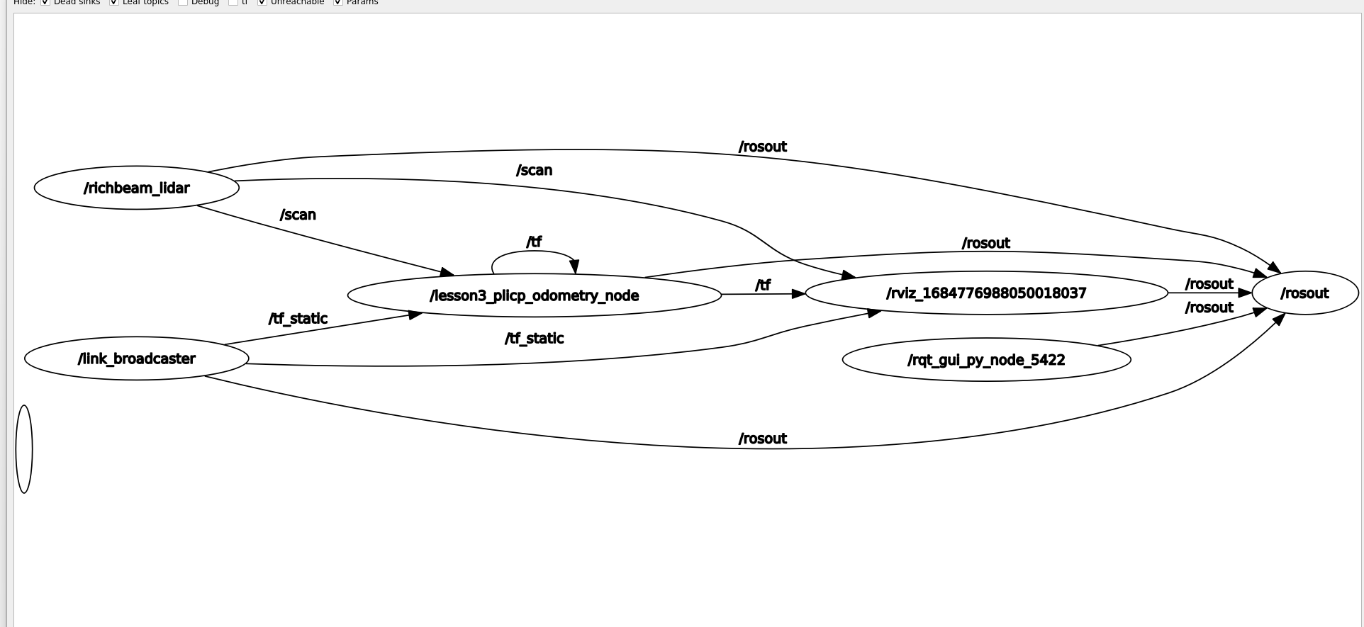

roslaunch lakibeam1 lakibeam1_scan.launch

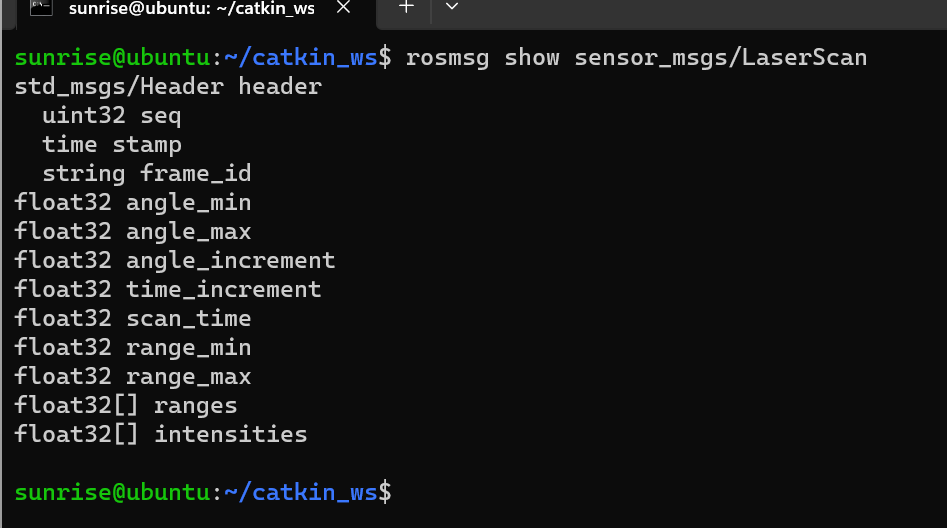

The data type of LiDAR is sensor_msgs/LaserScan, and its data format is as follows.
Under ROS, most sensor data comes with a header, which includes timestamps and coordinate systems, ranges arrays stored in radar data, and intensities data. This is a coordinate description using angle+distance - polar coordinate system. The rest are radar stored parameters.
Here we will make a simple demo, subscribe to the secretary information of the radar, and convert the description of this polar coordinate into a description in spatial Cartesian coordinates.

Here we use Lakibeam 1 LiDAR to implement a pure laser odometer based on the PL-ICP algorithm. The specific code is as follows.#include “lesson3/plicp_odometry.h”
#include “tf2_geometry_msgs/tf2_geometry_msgs.h”
ScanMatchPLICP::ScanMatchPLICP() : private_node_(“~”), tf_listener_(tfBuffer_)
ROS_INFO_STREAM(“\033[1;32m----> PLICP odometry started.\033[0m”);
laser_scan_subscriber_ = node_handle_.subscribe(
“scan”, 1, &ScanMatchPLICP::ScanCallback, this);
odom_publisher_ = node_handle_.advertise<nav_msgs::Odometry>(“odom”, 50);
InitParams();
scan_count_ = 0;
initialized_ = false;
base_in_odom_.setIdentity();
base_in_odom_keyframe_.setIdentity();
input_.laser[0] = 0.0;
input_.laser[1] = 0.0;
input_.laser[2] = 0.0;
// Initialize output_ vectors as Null for error-checking
output_.cov_x_m = 0;
output_.dx_dy1_m = 0;
output_.dx_dy2_m = 0;
ScanMatchPLICP::~ScanMatchPLICP()
void ScanMatchPLICP::InitParams()
private_node_.paramstd::string(“odom_frame”, odom_frame_, “odom”);
private_node_.paramstd::string(“base_frame”, base_frame_, “base_link”);
// **** keyframe params: when to generate the keyframe scan
// if either is set to 0, reduces to frame-to-frame matching
private_node_.param(“kf_dist_linear”, kf_dist_linear_, 0.1);
private_node_.param(“kf_dist_angular”, kf_dist_angular_, 5.0 * (M_PI / 180.0));
kf_dist_linear_sq_ = kf_dist_linear_ * kf_dist_linear_;
private_node_.param(“kf_scan_count”, kf_scan_count_, 10);
// comments copied from algos.h (by Andrea Censi)
// Maximum angular displacement between scans
if (!private_node_.getParam(“max_angular_correction_deg”, input_.max_angular_correction_deg))
input_.max_angular_correction_deg = 45.0;
// Maximum translation between scans (m)
if (!private_node_.getParam(“max_linear_correction”, input_.max_linear_correction))
input_.max_linear_correction = 1.0;
// Maximum ICP cycle iterations
if (!private_node_.getParam(“max_iterations”, input_.max_iterations))
input_.max_iterations = 10;
// A threshold for stopping (m)
if (!private_node_.getParam(“epsilon_xy”, input_.epsilon_xy))
input_.epsilon_xy = 0.000001;
// A threshold for stopping (rad)
if (!private_node_.getParam(“epsilon_theta”, input_.epsilon_theta))
input_.epsilon_theta = 0.000001;
// Maximum distance for a correspondence to be valid
if (!private_node_.getParam(“max_correspondence_dist”, input_.max_correspondence_dist))
input_.max_correspondence_dist = 1.0;
// Noise in the scan (m)
if (!private_node_.getParam(“sigma”, input_.sigma))
input_.sigma = 0.010;
// Use smart tricks for finding correspondences.
if (!private_node_.getParam(“use_corr_tricks”, input_.use_corr_tricks))
input_.use_corr_tricks = 1;
// Restart: Restart if error is over threshold
if (!private_node_.getParam(“restart”, input_.restart))
input_.restart = 0;
// Restart: Threshold for restarting
if (!private_node_.getParam(“restart_threshold_mean_error”, input_.restart_threshold_mean_error))
input_.restart_threshold_mean_error = 0.01;
// Restart: displacement for restarting. (m)
if (!private_node_.getParam(“restart_dt”, input_.restart_dt))
input_.restart_dt = 1.0;
// Restart: displacement for restarting. (rad)
if (!private_node_.getParam(“restart_dtheta”, input_.restart_dtheta))
input_.restart_dtheta = 0.1;
// Max distance for staying in the same clustering
if (!private_node_.getParam(“clustering_threshold”, input_.clustering_threshold))
input_.clustering_threshold = 0.25;
// Number of neighbour rays used to estimate the orientation
if (!private_node_.getParam(“orientation_neighbourhood”, input_.orientation_neighbourhood))
input_.orientation_neighbourhood = 20;
// If 0, it’s vanilla ICP
if (!private_node_.getParam(“use_point_to_line_distance”, input_.use_point_to_line_distance))
input_.use_point_to_line_distance = 1;
// Discard correspondences based on the angles
if (!private_node_.getParam(“do_alpha_test”, input_.do_alpha_test))
input_.do_alpha_test = 0;
// Discard correspondences based on the angles - threshold angle, in degrees
if (!private_node_.getParam(“do_alpha_test_thresholdDeg”, input_.do_alpha_test_thresholdDeg))
input_.do_alpha_test_thresholdDeg = 20.0;
// Percentage of correspondences to consider: if 0.9,
// always discard the top 10% of correspondences with more error
if (!private_node_.getParam(“outliers_maxPerc”, input_.outliers_maxPerc))
input_.outliers_maxPerc = 0.90;
// Parameters describing a simple adaptive algorithm for discarding.
// 1) Order the errors.
// 2) Choose the percentile according to outliers_adaptive_order.
// (if it is 0.7, get the 70% percentile)
// 3) Define an adaptive threshold multiplying outliers_adaptive_mult
// with the value of the error at the chosen percentile.
// 4) Discard correspondences over the threshold.
// This is useful to be conservative; yet remove the biggest errors.
if (!private_node_.getParam(“outliers_adaptive_order”, input_.outliers_adaptive_order))
input_.outliers_adaptive_order = 0.7;
if (!private_node_.getParam(“outliers_adaptive_mult”, input_.outliers_adaptive_mult))
input_.outliers_adaptive_mult = 2.0;
// If you already have a guess of the solution, you can compute the polar angle
// of the points of one scan in the new position. If the polar angle is not a monotone
// function of the readings index, it means that the surface is not visible in the
// next position. If it is not visible, then we don’t use it for matching.
if (!private_node_.getParam(“do_visibility_test”, input_.do_visibility_test))
input_.do_visibility_test = 0;
// no two points in laser_sens can have the same corr.
if (!private_node_.getParam(“outliers_remove_doubles”, input_.outliers_remove_doubles))
input_.outliers_remove_doubles = 1;
// If 1, computes the covariance of ICP using the method http://purl.org/censi/2006/icpcov
if (!private_node_.getParam(“do_compute_covariance”, input_.do_compute_covariance))
input_.do_compute_covariance = 0;
// Checks that find_correspondences_tricks gives the right answer
if (!private_node_.getParam(“debug_verify_tricks”, input_.debug_verify_tricks))
input_.debug_verify_tricks = 0;
// If 1, the field ‘true_alpha’ (or ‘alpha’) in the first scan is used to compute the
// incidence beta, and the factor (1/cos^2(beta)) used to weight the correspondence.");
if (!private_node_.getParam(“use_ml_weights”, input_.use_ml_weights))
input_.use_ml_weights = 0;
// If 1, the field ‘readings_sigma’ in the second scan is used to weight the
// correspondence by 1/sigma^2
if (!private_node_.getParam(“use_sigma_weights”, input_.use_sigma_weights))
input_.use_sigma_weights = 0;
void ScanMatchPLICP::ScanCallback(const sensor_msgs::LaserScan::ConstPtr &scan_msg)
current_time_ = scan_msg->header.stamp;
if (!initialized_)
// caches the sin and cos of all angles
CreateCache(scan_msg);
if (!GetBaseToLaserTf(scan_msg->header.frame_id))
ROS_WARN(“Skipping scan”);
return;
LaserScanToLDP(scan_msg, prev_ldp_scan_);
last_icp_time_ = current_time_;
initialized_ = true;
return;
start_time_ = std::chrono::steady_clock::now();
LDP curr_ldp_scan;
LaserScanToLDP(scan_msg, curr_ldp_scan);
end_time_ = std::chrono::steady_clock::now();
time_used_ = std::chrono::duration_cast<std::chrono::duration>(end_time_ - start_time_);
ScanMatchWithPLICP(curr_ldp_scan, current_time_);
void ScanMatchPLICP::CreateCache(const sensor_msgs::LaserScan::ConstPtr &scan_msg)
a_cos_.clear();
a_sin_.clear();
double angle;
for (unsigned int i = 0; i < scan_msg->ranges.size(); i++)
angle = scan_msg->angle_min + i * scan_msg->angle_increment;
a_cos_.push_back(cos(angle));
a_sin_.push_back(sin(angle));
input_.min_reading = scan_msg->range_min;
input_.max_reading = scan_msg->range_max;
bool ScanMatchPLICP::GetBaseToLaserTf(const std::string &frame_id)
ros::Time t = ros::Time::now();
geometry_msgs::TransformStamped transformStamped;
try
transformStamped = tfBuffer_.lookupTransform(base_frame_, frame_id,
t, ros::Duration(1.0));
catch (tf2::TransformException &ex)
ROS_WARN(“%s”, ex.what());
ros::Duration(1.0).sleep();
return false;
tf2::fromMsg(transformStamped.transform, base_to_laser_);
laser_to_base_ = base_to_laser_.inverse();
return true;
void ScanMatchPLICP::LaserScanToLDP(const sensor_msgs::LaserScan::ConstPtr &scan_msg, LDP &ldp)
unsigned int n = scan_msg->ranges.size();
ldp = ld_alloc_new(n);
for (unsigned int i = 0; i < n; i++)
// calculate position in laser frame
double r = scan_msg->ranges[i];
if (r > scan_msg->range_min && r < scan_msg->range_max)
// fill in laser scan data
ldp->valid[i] = 1;
ldp->readings[i] = r;
else
ldp->valid[i] = 0;

void ScanMatchPLICP::PublishTFAndOdometry()
geometry_msgs::TransformStamped tf_msg;
tf_msg.header.stamp = current_time_;
tf_msg.header.frame_id = odom_frame_;
tf_msg.child_frame_id = base_frame_;
tf_msg.transform = tf2::toMsg(base_in_odom_);
tf_broadcaster_.sendTransform(tf_msg);
nav_msgs::Odometry odom_msg;
odom_msg.header.stamp = current_time_;
odom_msg.header.frame_id = odom_frame_;
odom_msg.child_frame_id = base_frame_;
tf2::toMsg(base_in_odom_, odom_msg.pose.pose);
odom_msg.twist.twist = latest_velocity_;
odom_publisher_.publish(odom_msg);
bool ScanMatchPLICP::NewKeyframeNeeded(const tf2::Transform &d)
scan_count_++;
if (fabs(tf2::getYaw(d.getRotation())) > kf_dist_angular_)
return true;
if (scan_count_ == kf_scan_count_)
scan_count_ = 0;
return true;
double x = d.getOrigin().getX();
double y = d.getOrigin().getY();
if (x * x + y * y > kf_dist_linear_sq_)
return true;
return false;
int main(int argc, char **argv)
ros::init(argc, argv, “lesson3_scan_match_plicp_node”);
ScanMatchPLICP scan_match_plicp;
ros::spin();
return 0;
#include "lesson3/plicp_odometry.h"
#include "tf2_geometry_msgs/tf2_geometry_msgs.h"
ScanMatchPLICP::ScanMatchPLICP() : private_node_("~"), tf_listener_(tfBuffer_)
ROS_INFO_STREAM("\033[1;32m----> PLICP odometry started.\033[0m");
"scan", 1, &ScanMatchPLICP::ScanCallback, this);
odom_publisher_ = node_handle_.advertise<nav_msgs::Odometry>("odom", 50);
InitParams();
scan_count_ = 0;
private_node_.param<std::string>("odom_frame", odom_frame_, "odom");
ldp->valid[i] = 1;
else
ldp->valid[i] = 0;
ldp->readings[i] = -1; // for invalid range
ldp->theta[i] = scan_msg->angle_min + i * scan_msg->angle_increment;
ldp->cluster[i] = -1;
ldp->min_theta = ldp->theta[0];

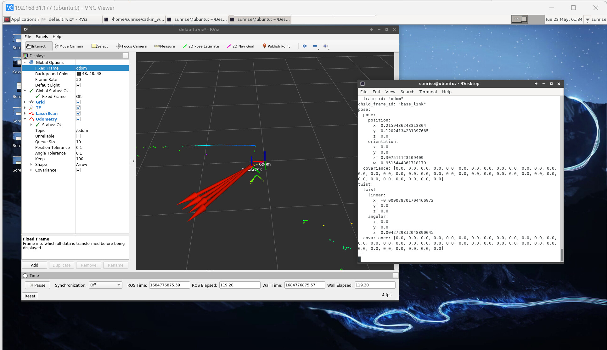

The running effect is shown in the figure.

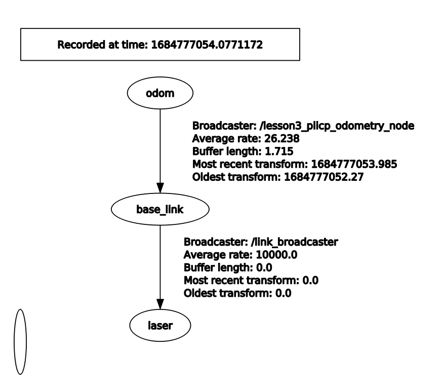

The tf is relatively simple, with a fixed pose between the laser and base_link. Here, the static tf is directly released; Baseunlink and odom have coordinate relationships provided by radar odometer data, so this is a dynamic tf that is calculated and sent out together with odom data.
Let’s take a look at the node relationship diagram section of rqt_graph. lesson3_plicp-odometry node has subscribed to the radar data and static TF coordinate system of lakibeam_lidar, and the display of odom data in Rviz is published through TF.
