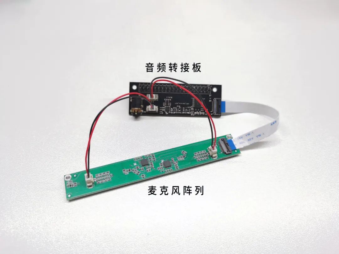

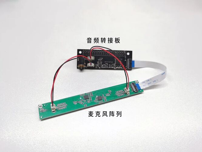

② Microphone array and switching board
③robot

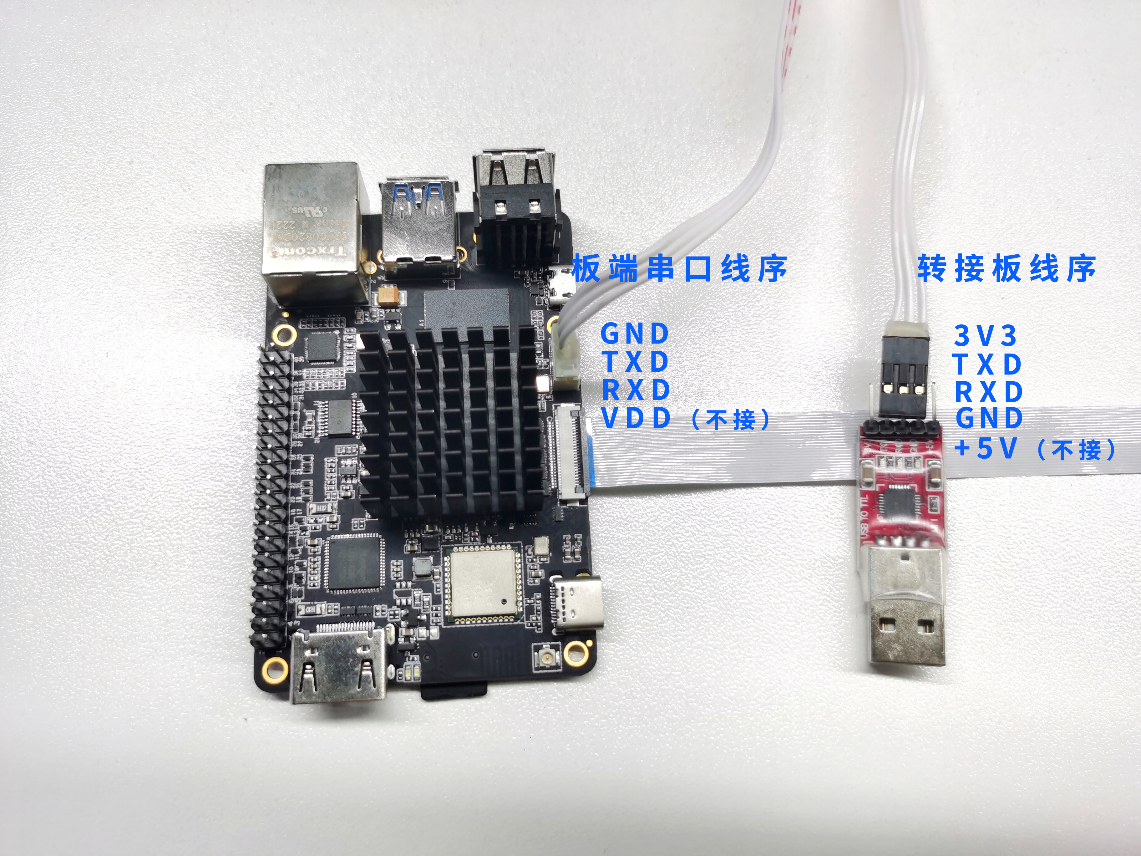

b. Serial cable. The connection method is as follows:

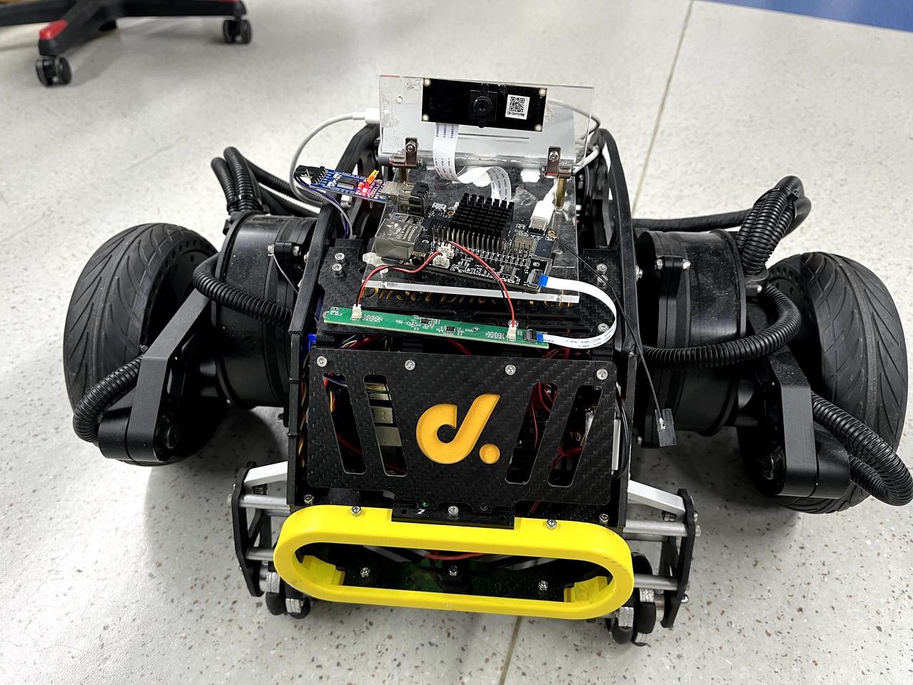

Install the X3 pie on the robot
Install the X3 pie on the robot and test the ability to control the robot’s movement on the X3 pie via the publish /cmd_vel topic.
First, the audio board needs to be installed on the X3 pie, and second, the X3 pie installed with a linear four-mic microphone array is directly fixed to the robot, and the robot’s USB control interface is plugged into the X3 pie.
The installation effect is as follows:
After installation, you can control the robot movement to see if the installation is successful.

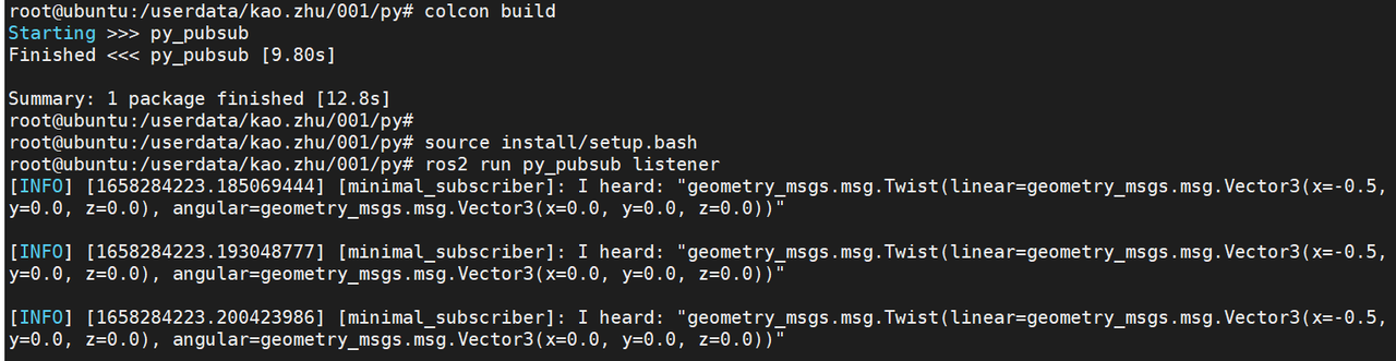

X3 switches on a terminal and controls the robot to rotate at 0.3r/s by publishing /cmd_vel topic messages:
source /opt/tros/setup.bash
ros2 topic pub -r 10 /cmd_vel geometry_msgs/Twist '{linear: {x: 0, y: 0, z: 0}, angular: {x: 0, y: 0, z: 0.3}}'
After the command is successfully executed, the following information is displayed:
The effect of robot rotation after receiving the control command is as follows:
It indicates that the robot can move correctly according to the issued control command message.

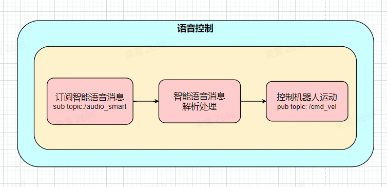

In Chapter 4, the script hobot_audio_control.launch.py and the motion control Node are respectively started in the two terminals of the X3 unit to realize the effect of controlling the robot by voice. This chapter analyzes the implementation principle.

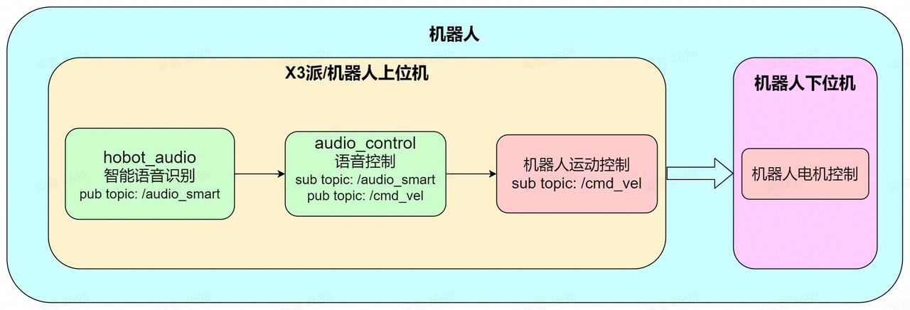

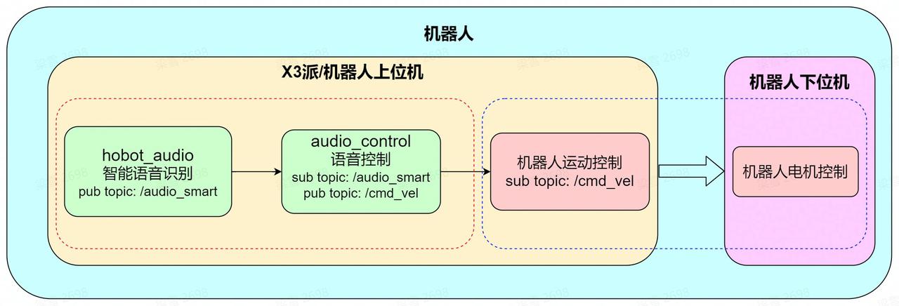

System design of App
For a complex robot system, the upper computer and the lower computer are generally configured on the robot. The upper computer of the robot has strong computing power, and can perform complex upper-layer applications of the robot, and at the same time, it can shield the bottom differences of different types of robots to the greatest extent. The robot lower machine generally uses a low-cost MCU processor to collect/control data of various sensors and hardware on the robot body.
The voice controlled robot is composed of two parts, including the upper computer and the lower computer. The upper computer of the robot is X3, running multiple ROS2 nodes, including perception, interaction and control functions. The robot lower machine is a part of the robot body (not explained in detail here). The detailed composition of each part is as follows:
As you can see from the App’s system design drawing, the X3 and TogetherROS robots can use the chip’s AI acceleration capabilities and the abundance of TogetherROS algorithms and robot development components to quickly develop smart robot applications.
The following sections describe each module in detail.

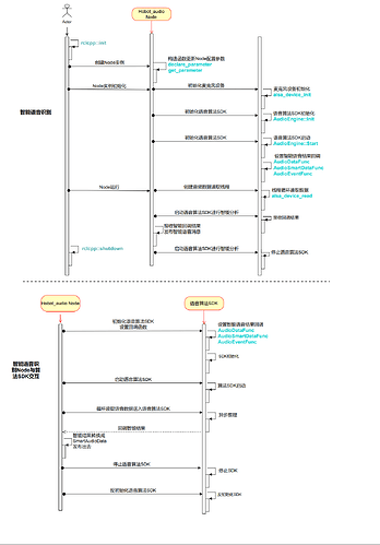

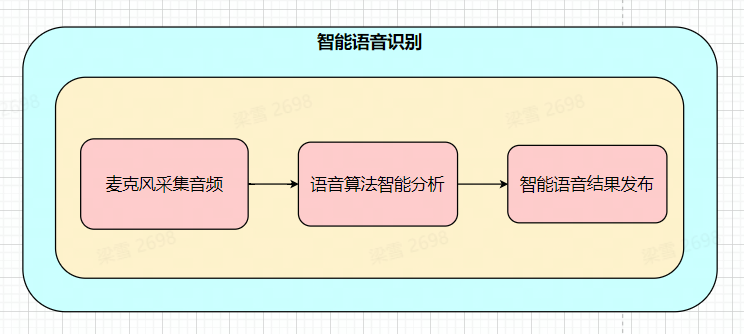

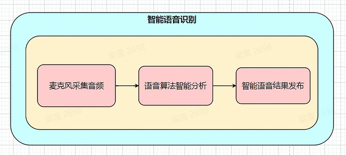

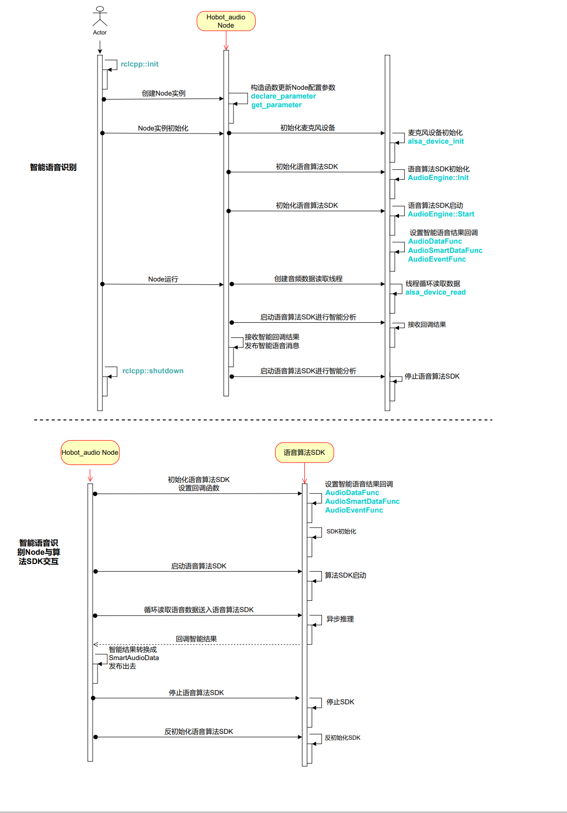

① Perception

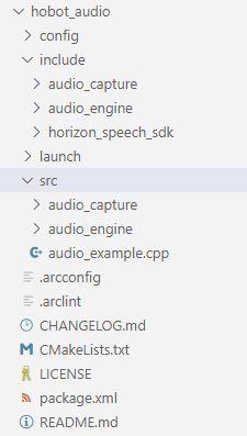

We use the Boxs algorithm repository in TogetherROS (which corresponds to hobot_audio in the system design diagram) to capture audio through intelligent speech recognition nodes and process it through intelligent speech algorithm recognition to publish intelligent voice messages. The main functions include:
a. The microphone collects audio
Intelligent speech recognition Node collects raw audio for speech algorithm module processing.
b. Intelligent analysis of speech algorithm
The intelligent speech recognition Node sends the collected original audio into the speech algorithm SDK module, and uses the BPU processor for AI reasoning through the speech algorithm SDK to realize the functions of noise reduction and recognition of the speech, and returns the intelligent result to the intelligent speech recognition Node in the form of callback.
c. Intelligent voice message release
After the intelligent speech recognition Node gets the intelligent result of the voice algorithm SDK callback, it converts it into the form of SmartAudioData, publishes the message of topic /audio_smart, provides subscriptions and controls the robot movement.
The corresponding package name of Node is ‘hobot_audio’ and the parameters of Node are specified:
“ai_msg_pub_topic_name” : publishes AI-aware results of intelligent voice messages. The default topic name is “/audio_smart”.
“config_path” : The configuration file path required for the intelligent voice recognition module to run, including the wake word and the command word that users expect to be recognized
The design and flow logic of Node are as follows:

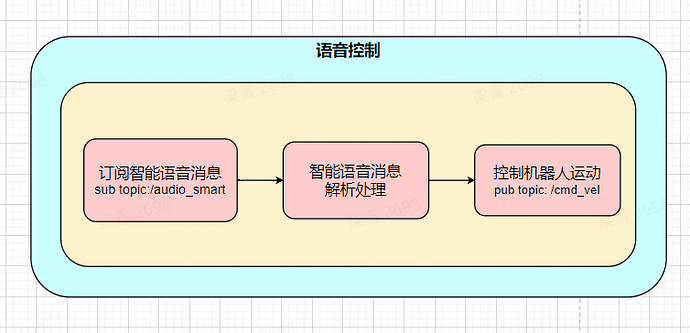

② Interaction
Voice control Node subscription intelligent voice recognition algorithm example published contains intelligent voice messages, according to the voice command words “go forward”, “backward”, “turn left”, “turn right” control messages, to control the movement of the robot.
The motion control message published by Node is the one defined in ROS2. The topic is “/cmd_vel” and the message type is “geometry_msgs/msg/Twist”. The corresponding package name of Node is ‘audio_control’ and the parameters of Node are specified:
“ai_msg_sub_topic_name”: Subscribe to the topic name" /audio_smart" that contains intelligent voice information.
“twist_pub_topic_name” : topic name for issuing motion control instruction messages “/cmd_vel”
“move_step”: the step size (speed) of the translation movement, 0.5 indicates that the moving speed is 0.5m/s, the larger the value, the faster the speed
“rotate_step”: the step size (speed) of the rotation movement, 0.5 indicates that the rotation speed is 0.5r/s, the higher the value, the faster the speed
If you need to control the robot movement through other command words, you can modify the relevant codes and configurations of intelligent voice recognition Node and voice control policy Node at the same time. For specific codes, see Code warehouse.

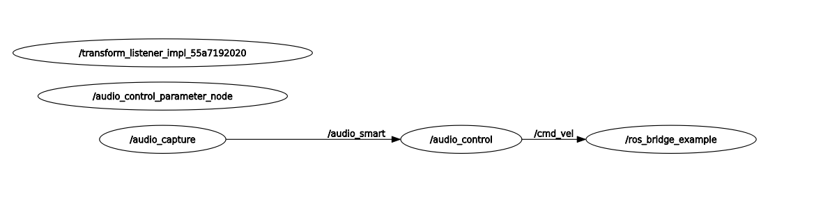

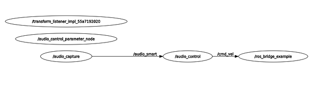

It is found that multiple nodes (corresponding to the started Node) are running on the X3 Node. Communication between these ROS2 nodes is based on pub&sub mechanism, and these nodes are connected in series through topic to form a pipeline.
Because there is a lot of Node and Topic information when the App is running, direct ros2 noce list cannot show the association between nodes. Node Graph function of rqt (ROS2 Foxy version and rqt need to be installed on PC, and PC needs to be in the same network segment as X3PC) can be used to visually display nodes running on X3PC, topics published and subscribed by Node, and the connection relationship between nodes. The following figure (where the Node name is in the oval box and the topic name is in the rectangular box) :
It can be seen that the whole graph (pipeline) starts from audio_capture Node (audio capture and intelligent voice recognition processing, package name hobot_audio), and passes through audio_control Node (receiving intelligent voice results, receiving intelligent voice recognition and processing). ros_bridge_example Node (robot motion control) is the end point, perfectly showing the connection between each Node.

② The final biped robot and robot motion control package

Taking a biped robot as an example, this paper describes the effect of a voice control App. The App does not depend on any form of robot. The motion control message published by the App is the message defined in ROS2 (topic is “/cmd_vel” and message type is “geometry_msgs/msg/Twist”). For details refer to the principle analysis in Chapter 5). As shown below, the composition of the App can be divided into two parts: the upper computer of the robot framed in red and the lower computer framed in blue:
① Red dotted box part
This part of the function does not depend on the robot, that is, it can be directly transplanted to any form of robot. The transplantation method is to install the X3 pie on the robot, and install the X3 pie with an audio microphone and TogetherROS as described in Section 2.
② Blue dotted line box
This part of the function depends on the robot, need targeted adaptation. According to the different state of the robot, the corresponding adaptation methods are different. In state 1, there were upper and lower computers on the original robot. For example, Raspberry PI or Jetson Nano was used as the upper computer, and the upper computer had robot motion control Node. Need to recompile robot motion control Node on X3 pai; In state 2, the original robot had only the lower machine. After developing robot motion control Node (refer to components/xrrobot · develop · HHP/app/xr_robot · GitLab (horizon.ai)), compile robot motion control Node on X3.
What microphone arrays does the App support? Can I change my own microphone to pick up the sound?
The App has no requirements for the microphone, but the audio acquisition part of the Horizon robot platform intelligent voice recognition Node is only adapted to the linear four-mic microphone array adapted to X3. If the user needs to use other microphone arrays, it needs to be adapted at the system level, including the audio driver, because it involves related modifications such as the system image driver, which will not be discussed here. Users can also obtain voice through other means, such as the network, or audio files, but these methods require users to modify the code adaptation.
How to adapt my own speech algorithm?
The integrated speech algorithm of the intelligent speech recognition module is integrated through the SDK. For details, see the Perception section of 5.2.
Take a look at the code directory structure:
The horizon_speech_sdk in the include folder of the code is the Horizon Speech algorithm SDK, including the speech algorithm reasoning module. Code each folder description is as follows:
audio_capture: indicates the code related to the audio capture function
audio_engine: Speech algorithm SDK interactive code
horizon_speech_sdk: Speech algorithm SDK external headers and so library
config: The configuration file required for the program to run
Users who want to use their own speech algorithms to experience the effects can directly modify the audio_engine code and remove the horizon_speech_sdk.
How to adjust the speed of the robot?
The motion startup script of the voice-controlled robot is hobot_audio_control.launch.py. At present, the default speed (translation 0.3, rotation 0.5) is adopted for robot motion control by word APP. If you need to modify, you can add two parameters “move_step” and “rotate_step” in the script, which can control the translation and rotation speed of the robot:
Node(
package='audio_control',
executable='audio_control',
output='screen',
parameters=[
{"ai_msg_sub_topic_name": "/audio_smart"},
{"twist_pub_topic_name": "/cmd_vel"},
{"move_step": 0.3},
{"rotate_step": 0.5}
arguments=['--ros-args', '--log-level', 'error']
For details about the parameters, see Section 5.2.
How to develop an application Node to extend the voice App functionality?
You can refer to the code of audio_control Node in components/xrrobot · develop · HHP/app/xr_robot · GitLab (horizon.ai) to achieve the function.
TogetherROS provides a smart speech recognition Node that supports user-defined voice recognition wake words and command words, as well as voice DOA output so that users can define different command words by modifying the configuration of the smart speech recognition Node, and the smart speech recognition Node will publish the smart result through a message. Help users quickly develop various application examples on the X3 pie.

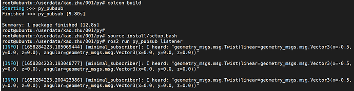

Can I develop a python Node extension App feature?
Yes, ROS2 supports cross-device, cross-platform, cross-language, and TogetherROS is fully compatible with the ROS2 Foxy version, so it also supports these features. For example, an LED light is installed on the 40PIN of the X3 pie, and the LED light is lit when the robot is in motion. Users can use python to develop a ROS Node, subscribe to the message published by the voice interaction Node whose topic is “/cmd_vel”, and check whether the control command in the message is the start motion command (whether the value is non-0). If there is a non-0 value, it means that the start motion is and the LED light is on; otherwise, the LED light is off.
After using python to develop Node, compile and run directly on the X3 pie, subscribe to the cmd_vel topic message python code sample:
import rclpy
from rclpy.node import Node
from geometry_msgs.msg import Twist
class MinimalSubscriber(Node):
def __init__(self):
super().__init__('minimal_subscriber')
self.subscription = self.create_subscription(
Twist,
'cmd_vel',
self.listener_callback,
10)
self.subscription # prevent unused variable warning
def listener_callback(self, msg):
self.get_logger().info('I heard: "%s"\n' % msg)
def main(args=None):
rclpy.init(args=args)
minimal_subscriber = MinimalSubscriber()
rclpy.spin(minimal_subscriber)
# Destroy the node explicitly
# (optional - otherwise it will be done automatically
# when the garbage collector destroys the node object)
minimal_subscriber.destroy_node()
rclpy.shutdown()
if __name__ == '__main__':
main()
